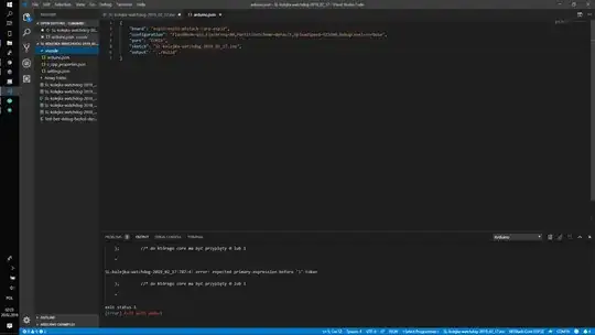

When You add folder with sketch, you are creating "so called" project. VS code puts there some hidden folders with the project configuration files. To see them from windows file explorer you may enable show hidden files. than in your project folder You may find .vscode , and there is the arduino.json file.
More simple way is just click on the project navigation bar on the left, and open there the .vscode folder and using vscode as editor just add
"output": "../ArduinoOutput" or "output": "../build" or whatever you want to name that folder.
".." tells that it is one level above the "project folder" so it is "outside" as VScode wants.
And as far as i know this is not global setting, so You need to set it for every project if you want it.
Check the proper formatting in order to save file, use code hints to add options in file.
Hope that this is as clear as possible and help others to find that magic arduino.json file and understand where what and why.
