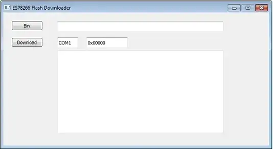

As I stated in my post I did it by mistake. Nonetheless I was able to fix it by using a different flashing tool that used just one .bin file instead of many like the official ESP8266 tool does.
Can anyone please explain me why is that? Why are there different tools to flash the ESP8266? In concrete, why one requires just one file that will update the SDK and AT firmware in one pass, and the other requires many differente files? Or just a link to a site o post so I can better understand the differences?
The tool I ended up usign is "ESP8266 Flash Downloader"
The file I used: AiThinker_ESP8266_DIO_8M_8M_20160615_V1.5.4.bin
Thanks!
