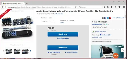

Exactly this: product image

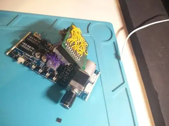

tl;dr it's a 4 in 1 out audio selector with motorised volume pot controllable by an IR remote. But it's got a lot of issues so i've enjoyed hacking it. I will release full details maybe with a re-done PCB layout should people wish to grab a board / diy kit, but at the moment it looks like this:
Why am i hacking it?
As is, it's closed hardware and closed software, the MCU itself is an STC15W408AS which prides itself on not being able to have its flash memory read, and believe me it does it's job well; I've clearly removed it and pulled out the SOP20 footprint to another pcb that can talk to either the original IC, or an arduino nano. the volume pot as well is too slow and requires tapping to change, the relays are not latching so consume a lot of power, the whole unit consumes too much power, and i've more of less changed the majority of the components and layout.
