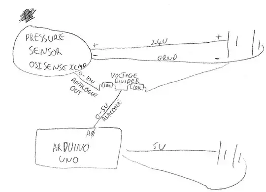

I'm using a Arduino Uno to read pressure and I want to know if I have wired/coded the sensor correctly. I'm not sure I'm getting the correct readings (it could be the right readings - I just want to check I have done everything right). The sensor I am using is an OsiSenseā„¢ XMLP pressure sensor that reads between 0 and 100 bars and gives out a 0v (zero bars) to 10v (100 bars) charge. Due to the Arduino Uno only being capable of reading up to 5 volts, I've used a voltage divider to reduce the maximum voltage the Arduino receives to 5v.
I've attached a hand-written diagram. Let me know if you need any more information. I've attached the wiring and also the code.

Edit: Also, make sure you connect all ground lines together, both from the sensor and the Arduino!

I assume you have read @edgar-bonet about connecting the GND's.

Everything is just fine.
All you have to do is to provide the common ground (0 potential) to your Arduino and your Sensor.
The problem here is that they might be on a different potential.
So just connect the ground of your 5 volts and 24 volts together and everything will work perfectly.
