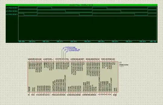

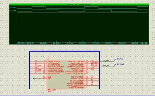

edit: i decided to give it a try.
the following code:
  pwm1Set(TMR1_PS8x, F_CPU / F_PWM1 / 8);       //ps = 8x, top = F_CPU / F_PWM / 8 = 80
  analogWrite(9, 20);                           //dc = 20/80=25%
  analogWrite(10, 40);                          //dc = 40/80=50%
  // put your main code here, to run repeatedly:
produced the following output on an ATMega328p's TIMER1.
i'm reasonably sure that the output is indeed 25Khz.
the code itself however is capable of generating pwm at other frequencies.
edit2: the same code on mega2560 generating 25Khz pwm on pin6/7/8:
code used for that is as follows:
  //DC on Pin 6 = 20/80 = 25,
  //DC on Pin 7 = 40/80 = 50,
  //DC on Pin 8 = 60/80 = 75,
  pwm4Set(TMR4_PS8x, F_CPU / F_PWM4 / 8); analogWrite(6, 20);  analogWrite(7, 40);  analogWrite(8, 60);
pwm4Set() is a copy of pwm1Set(). Both are simple enough: only 5 lines of code used.
