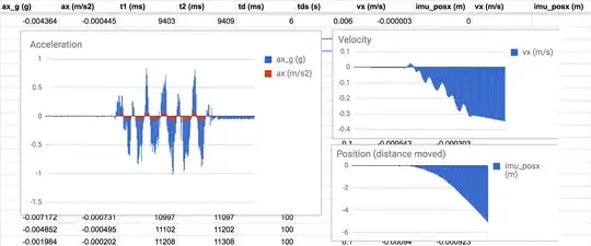

I want to calculate the displacement of the Arduino 101 board compared to the starting point (only in the x direction so far).
In below data I'm swinging the board multiple times in circles around my laptop and then putting it back at the origin a few seconds later.
Regardless if 1ms-100ms between the loops, the numbers show no sign of the board returning to the origin. I've calibrated the accelerometer x-axis as closely as possible.
Results from swinging
Am I doing something wrong in deriving the acceleration/velocity/distance, or is this the level of compounding error to expect?
If so, can combining gyro data correct acceleration (thought it mainly worked the other way around)?
I have a GPS meant for correcting position but was hoping any drift wouldn't be this quick.
EDIT: I was incorrect re. use of gyro data; the attitude of the board, which was not consistent in my swings, will effect the acceleration output. Gyro data can be used to calculate and "cancel out" this gravitational impact, and get a more accurate (linear) acceleration (http://www.cl.cam.ac.uk/research/dtg/www/files/publications/public/abr28/ojw28_thesis.pdf). Will report back in a few days.

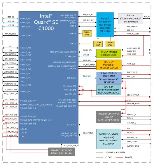

The Arduino 101 contains the Intel® Curie™ Module, this module contains an Inertial Measurements Unit or IMU for short among other sensors and peripherals Intel® Curie™ Module Block Diagram

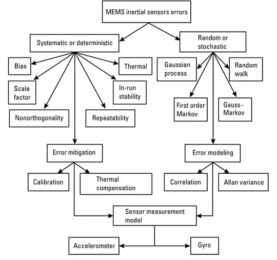

The IMU of this module is Bosch BMI160 which is a low cost MEMS IMU, this IMUs typically suffer from systematic errors and random/stochastic errors, the following diagram summarize them: enter image description here
If we take the bias error as an example of those errors, an uncompensated accelerometer bias introduces an error proportional to time (t) in the velocity and proportional to t^2 in the position. For example, consider a case where accelerometer bias is 10 m/s^2. If this bias offset is not removed from the measurements, it can generate a 500 m error in position after 10 seconds and 12.5 km error after 50 seconds. Let us back to our IMU, if we read the data sheet the Zero-g error "or bias" is 40mg for the 8g sensing accelerometer and Ta = 25 Celsius with normal VDD and the IC has been assembled on board. If we just consider this 40mg bias error "dropping other error sources" it is 0.392266 m/s^2 so after 10 seconds the position offset will be 1.96133 meter even if you don't move the Arduino. I suggest you read "MEMS-Based Integrated Navigation" book here it will give you a good vision about MEMS based inertial sensors and basic navigation concepts.
