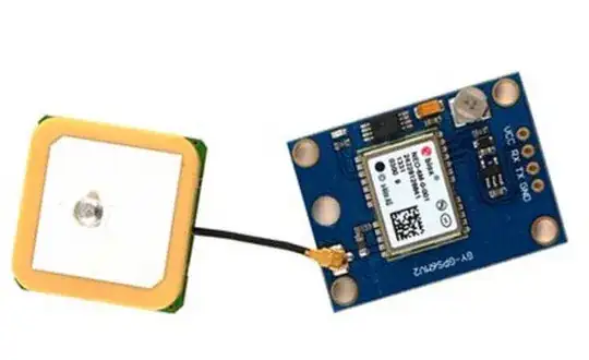

They vary in price from a few GB pounds to well over a hundred GB pounds. It all depends on what you need from it, and what you can afford. Personally, I got very good results from cheap (~ £5 GB) Neo-6M modules (like the one shown here) with some mobile robots I was experimenting with.
neo-6m
Now, I've just typed "Neo-6m GPS Arduino" into Google, and one of the first sites was this Instructable, which has more than enough information to get you going with this combination.
