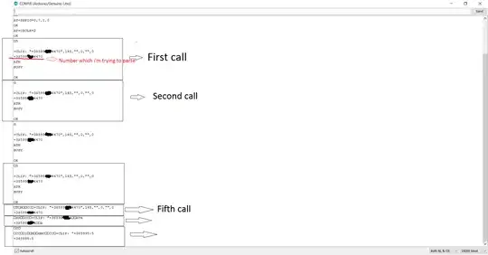

i'm working on project where i'm trying to achieve that arduino parse caller ID so i can use it later to send SMS with sensor reading data.
Somehow i made that code (with much googling) and it works great... But when i include arduino sleep part, it does work at beginning, but after i call SIM800 4-5 times with distinct of 30 seconds, i get unusable data on Serial, so i can't no longer parse correct number.
I tried many things, dropping baud rate to 1200, changing delay, but still i get strange characters after few calls.
Can anyone help me?
P.S. ATMEGA328P ic MCU
Thank you, Matija

Serial OUTPUT

When you use sleep mode SLEEP_MODE_PWR_DOWN you're turning off all of the microcontroller's timers, Including the timer SoftSerial is using. I expect that turning off and then when wake from sleep turning back on the timers is affecting the timing of your serial communications.
Try using SLEEP_MODE_IDLE instead of SLEEP_MODE_PWR_DOWN and see if it corrects the problem.
