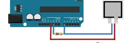

  2. How should I best distribute power to all the strips and for each switch? This is how I understand to setup 1 of the switches:

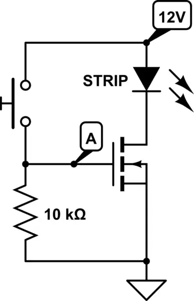

Unless you want to do fancy things with the LED strips you really don't need an Arduino to accomplish this task. You can just switch each strip with a powerful enough MOSFET and control the gate with the sensor:
schematic
If you really want the Arduino (for example to add effects like delays, fading, blinking patterns, etc) it would basically go into the circuit at point A in the circuit. The sensor into an input and the MOSFET into an output.
Since these are just presence sensors (not pressure sensors, they don't sense pressure, only presence) you don't need an analog input to read them - a digital one will suffice and also make your programming simpler.
You can use shift registers or IO expanders to increase the number of input and output pins you have, or you can use a larger Arduino with more pins.
