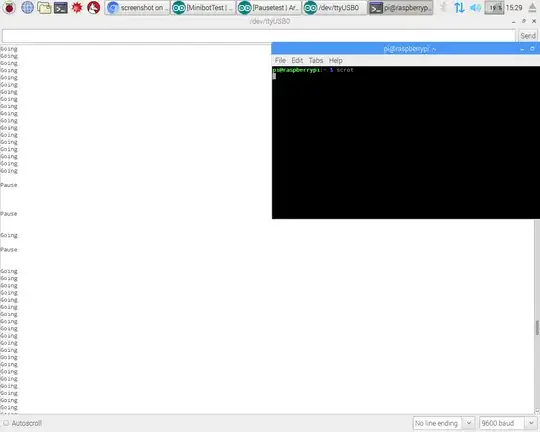

I'm using a simple microswitch on pin 2, to activate an external interrupt.
void pause()
  Serial.print("\n\nPause\n\n");
  delay(1000);
void setup()
  pinMode(2, INPUT_PULLUP);
  attachInterrupt(0, pause, RISING);
  Serial.begin(9600);
  delay(1000);
void loop()
  Serial.print("\nGoing");
  delay(100);
When I tap the micro switch, some reason, my serial monitor output looks like this:
Just to clarify, there is no delay between any of
Is this just some serious debouncing, causing my Arduino to find lots of rising instances? or is there some kind of problem in my code?

Yes, it is bouncing of your button.
You are seeing it because delay() does not work, and cannot be used, in an interrupt.
Also delaying in an interrupt is completely opposite to the whole ethos of interrupt programming.

your code works as coded - whether it works as expected is unknown.
basically the isr is triggered on the first edge, and the execution loops around in the isr, and the execution returns one second later.
As a result, your code missed most of the "bouncing", actually it missed all bounces other than the very first one.
not an effective debouncing strategy.
yes, delays or while loops can be used in an isr, so long as you know what you are doing.
