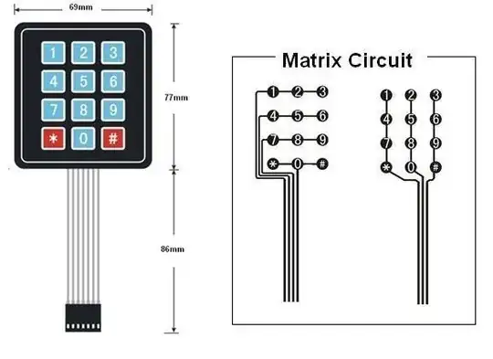

You have chosen a mighty task as your first project. I suggest that you run through as many of the example programs as possible before undertaking your project.
Firstly, I would recommend a matrix keypad instead of the DTMF keypad as it is much easier to use with an Arduino. This will also allow you to use a multiplexer which would use fewer pins.
Keypad and matrix circuit

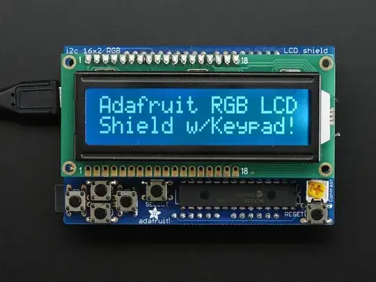

I2C allows you to communicate to the LCD with only 2 pins. Here is such a I2C LCD (with buttons) sold by Adafruit.
Adafruit I2C LCD + buttons
As well as the tutorial over at Adafruit, there is a tutorial on such a topic over at ArduinoInfo.
