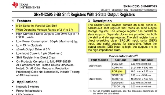

Adding to what @uint128_t said, if you really need to change the state of many pins at the same time, you can add some external latched shift registers as a SIPO (serial-in/parallel-out) interface towards the outer world.
The price you pay is that you have to load the entire register with the data you want to send before you can update the output pin states. This requires a clock cycle for each loaded bit (here I'm speaking of the clock of the external register, not Arduino's) and thus may add too much latency in your system, depending on what you are trying to do.
The 74HC595 is a classic (8-bit shift register with output latches), and can be cascaded to obtain a register of the desired width.
Here is an excerpt from the datasheet of TI's 74HC595 (yellow emphasis mine):
It's also sold in 16-pin DIP package, very convenient for breadboarding, in case you need it (common need for people that play with Arduinos).

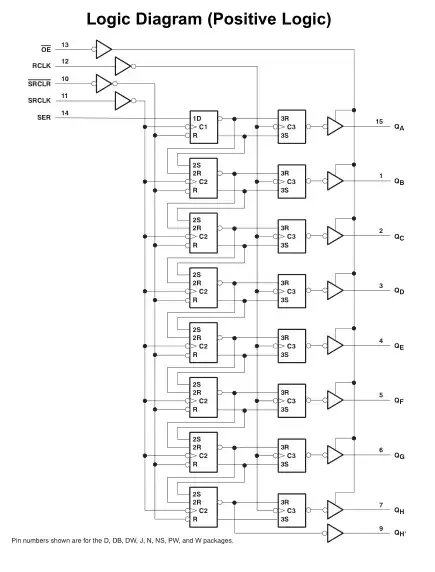

The internal logic diagram is the following (from the same datasheet):
It is so common in the Arduino world that there are also open libraries do drive it, for example this. But even without pre-written libraries, it is not difficult to drive it from an Arduino, if you have a little experience in digital logic and can understand the timing requirements stated in its datasheet (the table in section 7.6 is fairly easy to understand, once you know what setup and hold times are).
