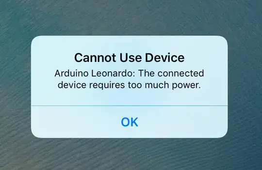

The problem I'm having is that when I connect the Leonardo to my iPad, the iPad shows an alert saying that the Leonardo is using too much power.
iPad too much power alert

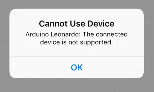

Tried running the board with an external power source. Then I get a different alert: Device not Supported.
At this point I believe that the problem is not necessarily power, but the fact that the Leonardo is announcing itself to the iPad and the iPad does not like it. In the UNO project, through re-flashing, the board acts only as a HID.

If indeed the descriptor is the problem then yes you can change it.
In the core file USBCore.h is the line:
#define D_CONFIG(_totalLength,_interfaces) \
    { 9, 2, _totalLength,_interfaces, 1, 0, USB_CONFIG_BUS_POWERED | USB_CONFIG_REMOTE_WAKEUP, USB_CONFIG_POWER_MA(500) }
Just change the 500 to something smaller (it has to be an even number).
However it may be that the Leonardo isn't programmed to support the Boot Protocol for HID. In which case that would require bigger changes to the USB and HID stacks in the core.

I have found the solution - your USB > Lightning adapter must has the option for charging.
For example i use Arduino Leonardo connected to IPhone 6 by USB to adapter who has USB nest and charging nest. IPhone shows me info that "This device is not supported.", but all works fine and I can control IPhone by Arduino Leonardo.
