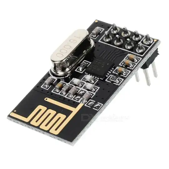

The RF radios I'm using are nRF24L01+ like this:
nRF24L01+
Datasheet: PDF Download

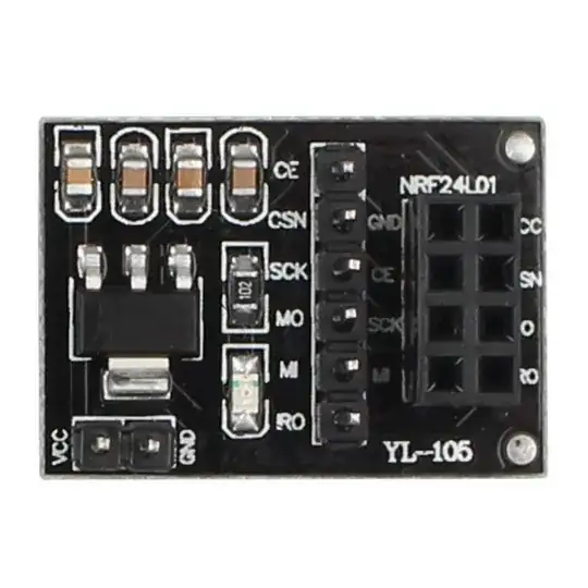

Update: I see people use various capacitors and/or a voltage regulator. I did not do that, but I have a an adapter from 5V->3.3V specifically for the nRF24L01 (like this). I think there is already a voltage regulator and needed capacitors on this board. As far as I know the IC on the adapter is the voltage regulator and the capacitor (one) is probably just above the GND/VCC connection in the picture above. Or a second capacitor left of the MI/IRQ
Adapter
