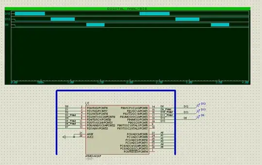

So I have this code running which I can compile but does not work:
because it is wrong.
try something like this instead:
  time_elapsed = millis() / 1000 - start_time;  //time past start time, in seconds
       if (time_elapsed < LOOP1_ENDTIME) loop1();
  else if (time_elapsed < LOOP2_STARTTIME) do_nothing();
  else if (time_elapsed < LOOP2_ENDTIME) loop2();
  else if (time_elapsed < LOOP3_STARTTIME) do_nothing();
  else start_time+=TOTAL_TIME; //update start time
edit 2:
so here is the above code in action.
three simple tasks: loop1() flips D12, loop2() flips D13 and loop3() flips D8.
The time duration + gaps for those tasks are specified by the following macros:
#define LOOP1_DURATION  5  //time in x100 ms for easier simulation
#define LOOP1_GAP       1
#define LOOP2_DURATION  4
#define LOOP2_GAP       2
#define LOOP3_DURATION  3
#define LOOP3_GAP       6
from those macros, I built the ending and starting time used in the code above.
the code is long-term error free and will never lose track of time.
As you can see, it is essentially a fancy way of executing the following:
  do {loop1();} while (loop1's time isn't up);
  do {nothing();} while (loop1's gap time isn't up);
  do {loop2();} while (loop2's time isn't up);
  do {nothing();} while (loop2's gap time isn't up);
the advantage with my implementation is that each loop run is very quick and you can execute other tasks as well.
But the general idea is the same.
