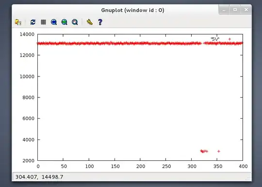

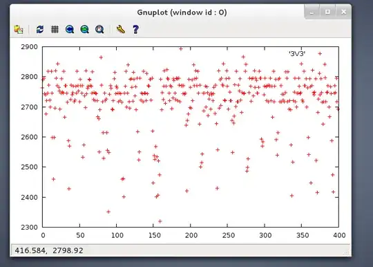

An extremely useful comparison of these modules (the first generation) running at both 3.3 and 5 V can be seen here, Re: Ultra cheap ultrasonics, and a bit of a challenge:
3V3
HC-SR04 running at 3V3
5V
HC-SR04 running at 5 V
Notwithstanding, the newer versions of the HC-SR04 may have an improved response.
