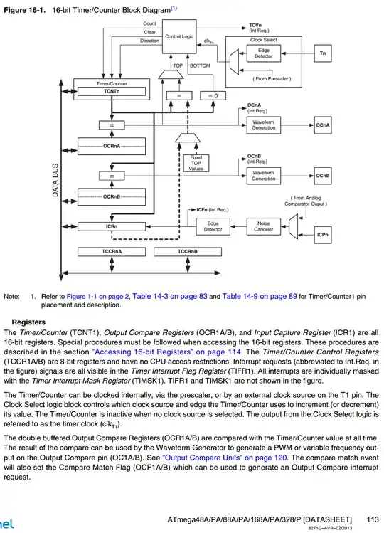

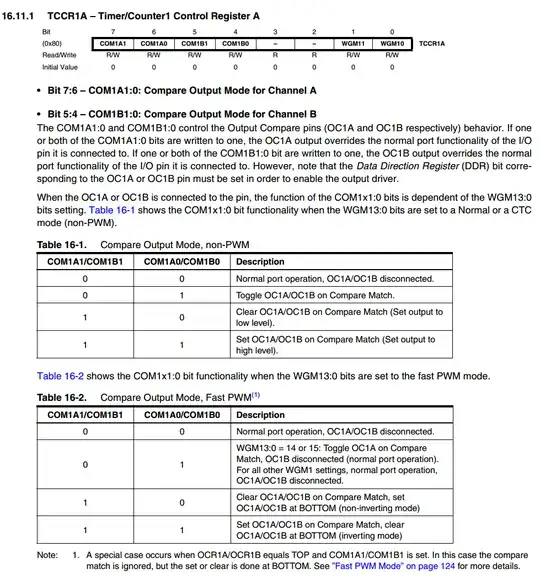

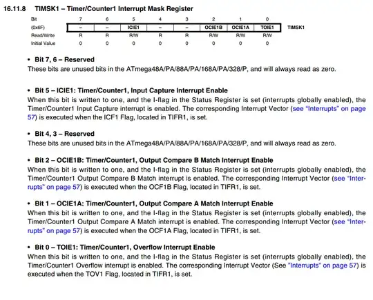

Select excerpts from the datasheet linked above:
enter image description here enter image description here enter image description here
So, for example, TIMSK1 |= (1 << TOIE1); sets the bit TOIE1 in TIMSK1. This is achieved by shifting binary 1 (0b00000001) to the left by TOIE1 bits, with TOIE1 being defined in a header file as 0. This is then bitwise ORed into the current value of TIMSK1, which effectively set this one bit high.
Looking at the documentation for bit 0 of TIMSK1, we can see it is described as
When this bit is written to one, and the I-flag in the Status Register is set (interrupts globally enabled), the Timer/Counter1 Overflow interrupt is enabled. The corresponding Interrupt Vector (See ”Interrupts” on page 57) is executed when the TOV1 Flag, located in TIFR1, is set.
All the other lines should be interpreted in the same manner.
