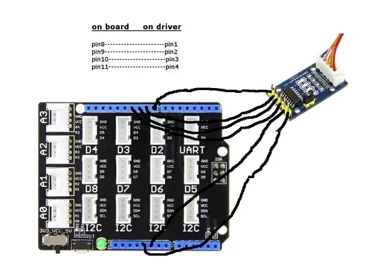

I am trying to connect a stepper motor ( this model exactly https://create.arduino.cc/projecthub/trduunze/grove-starter-kit-for-arduino-stepper-motor-driver-66471d ) in an arduino 101 but it does not work for some reason. I have tried connecting everything ast they tell in the website with no results:
Pinout from motor controller to arduino 101 grove shield
And then I tried connecting directly to the board without using the shield, and still getting nothing.

After a lot of messing around, I have only been able to light up one led in the controller connecting one of the motor cables to GPIO5. None of the other GPIOS seem to work with the step motor controller.
PayToPwn
  • 163
After reading the Stepper library and searching for several, I saw that in an example using an EDISON ( I want to thanks to Guimficus for posting his code here: https://communities.intel.com/thread/99133) they changed the pinMode of the GPIOS they were using in the setup function :
pinMode(8, OUTPUT);
pinMode(9, OUTPUT);
pinMode(10, OUTPUT);
pinMode(11, OUTPUT);
And after adding that seems to work like it is supposed to work.
