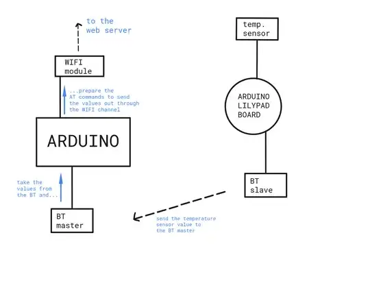

I am working on a project involving bluetooth and wifi communications. Both of them are wired up to the Arduino and communicate to it using two software serial port. The scenario is the one in the picture attached.
What I am doing is:
  • retrieve the sensor value
  • send it from the BT slave module to the master one (wired up to Arduino)
  • take it and send it, using AT commands, through the WIFI channel (the WIFI module is a ESP8266-01) to a web server.

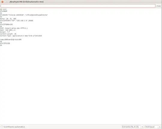

The problem is the code goes properly till the AT+CIPSEND command, then the POST request is sent but no good feedback arrives, ending with the "ERRORE" error message. enter image description here
[EDIT 2] Attached serial monitor output This is the serial monitor output when I execute the skecth. It seems to work properly but it does not upload any value. enter image description here

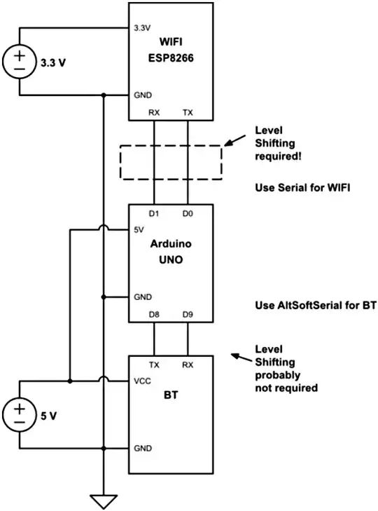

This answer provides full details on choosing "good" combinations of hardware and software serial ports. To summarize:
  • Use the HardwareSerial port (i.e., Serial) for one of the devices. You can still use it for debug prints, as long as the device has some kind of command "format". For example, if commands start with "AT", just make sure that none of your debug prints start with "AT". It is the absolute best choice. You would have to disconnect RX pin 0 from the device in order to upload new sketches over USB.
  • Use AltSoftSerial for the other device. It is the most efficient software serial port, and it can be used at the same time as Serial. It only works on two specific pins.
  • NeoSWSerial is the next best choice, at limited baud rates. It can be used with the above choices, but transmitting on NeoSWSerial prevents them from receiving.
  • SoftwareSerial is the worst choice. Receiving or transmitting on SoftwareSerial prevents all of the above from receiving anything. It disables interrupts for long periods of time.
UPDATE - Here is the most reliable configuration:
Your code will have something like this:
#include <AltSoftSerial.h>
AltSoftSerial BT; // 8 is RX, 9 is TX
#define WIFI Serial  // 0 is RX, 1 is TX (disconnect 0 to upload new sketch)
void setup()
  WIFI.begin( 115200 );
  BT.begin( 9600 );
void loop()
  if (BT.available) {
    char c = BT.read();
    // do something with the character
       ... save them until '\n' arrives?
         ... then parse some values?
    if (values all received) {
      Serial.print( F("Sending values") ); // this is the WIFI port, but
          //  the ESP8266 ignores this debug print because it doesn't
          //  start with "AT".
      WIFI.println( F("AT+ ...") ); // all the AT commands
      WIFI.print( btValue1 );    // and the BT values
