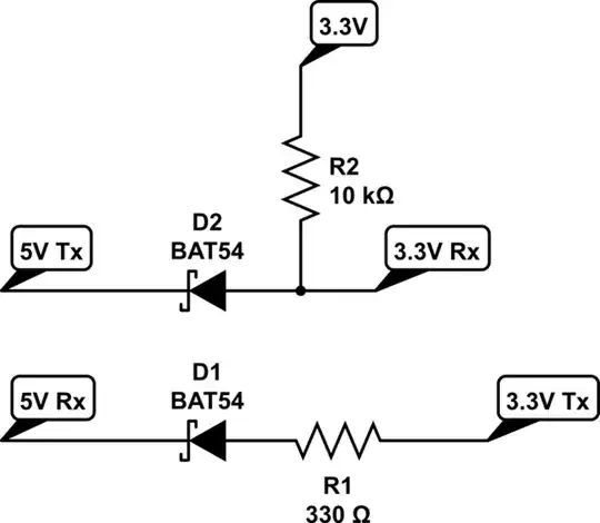

You can use something along the lines of this:
schematic
When the 5V Rx is driven to 5V D1 protects the 3.3V Tx pin.
When the 5V Rx is driven to 0V R1 protects the 3.3V Tx pin from excessive current draw.
When the 5V Tx is driven to 5V D2 protects the 3.3V Rx pin and R2 pulls the pin to 3.3V.
When the 5V Tx is driven to 0V D2 pulls the 3.3V Rx pin to ~0.2 V
Resistor values are rough guidelines, lower values will put more strain on the parts and increase power draw but will also increase the maximum UART speed that will work reliably.
