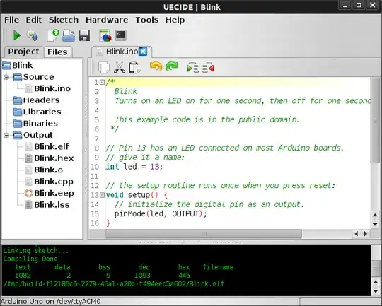

Use UECIDE. It does everything Arduino IDE does, can have multiple instances running out of the box, and projects/libraries are 100% compatibles.
You get a nice standard interface, with a project, edit and output panes.

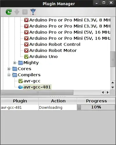

IDE can be extended with plugins:
Download it from the same site. You have versions for Windows, Mac and Linux:

As UECIDE follow follow strictly the rules for project/directory organization as standard Arduino IDE, libraries and projects are compatibles. You can use Arduino IDE and UECIDE on the same project without harm.
I used Arduino IDE at first, and later slowly migrate to UECIDE, keping both for a while, but right now I keep Arduino IDE only as a backup.
