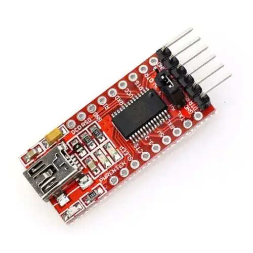

-A board very similar to this one. It has a chip with FT232 written on it, also FTDI in bold letters. usb to ttl
The big USB TTL pcb I was using has 5 output pins: 3v3, 5v, TX, RX, GND. Turns out this is not enough to program Arduino Pro as you need one more pin. If you don't connect this pin, avrdude just gets stuck after opening the COM port and waits indefinitely/until you kill the process. To even be able to see this USB TTL chip in Windows, you need to download a driver from the website(first link) and my guess is that the driver is buggy since it won't exit the process when it encounters this type of error, further leading to suspicious/dangerous behaviour which results in Windows completely shutting down all COM ports until next restart.

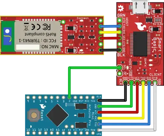

To get this pin(it's called DTR/GRN), I borrowed the other chip(3rd) and I connected it regarding to this scheme: https://cdn.sparkfun.com/assets/learn_tutorials/2/6/4/smartbasic_programming.png
I also had to download a different driver for it, I don't remember where I downloaded it from but it's called CDM21226 driver, when you install it it says FTDI driver installed.
