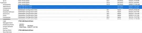

I removed the kext and pkg files for the FTDI drivers and deleted them completely, still when I open the System Report I still see the FTDI USB Serial Driver entry.
When I go to System Report > Hardware > USB I see this:
What is happening? Did the FTDI drivers got removed? If they did then why wont the serial usb port get detected on Arduino? If they are not removed completely then what did I miss?

I installed the CH340 Driver and the board now shows the USB serial as port option: https://github.com/adrianmihalko/ch340g-ch34g-ch34x-mac-os-x-driver
