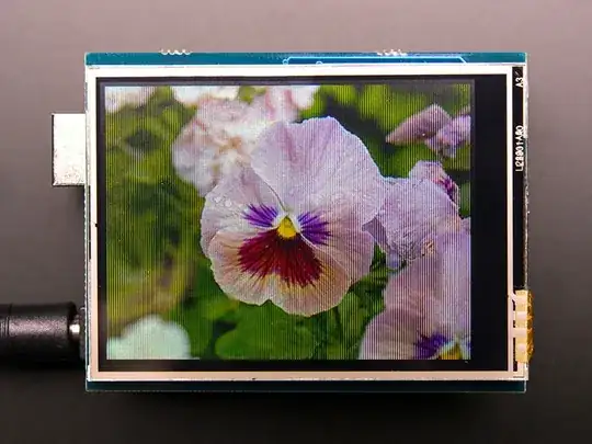

I've been trying to figure out a way to store an image on the Arduino, and I couldn't figure it out. What I've been trying to do with this image is the following:
  • Test that the arduino has the image by displaying on a touchscreen (I have the adafruit 2.8 inch touch screen)
  • Break down the image into an array, in which contains pixel by pixel color RGB color info of the image
int pictureData = [[100,50,0],[176,255,5],...]; // RGB Values within the array
How can I store an image and break it down as shown? Is there no way to do this? I would appreciate any help! Thank you very much!
I am using Arduino IDE for code and I have Arduino Uno/MEGA, which ever is necessary for this task. All info of screen is on adafruit: https://www.adafruit.com/product/376
The below image shows an example of displaying the image:
240 by 320 pixels. That's 76800 pixels. In your example it looks like you want 3 bytes per pixel, so that's 230400 bytes. An Arduino Mega has 8K bytes of SRAM memory. There's enough room in the memory on the Arduino Mega to hold 0.003% of your image.
Maybe you could store the image on an SD card and put it on the screen little piece by little piece, but that is going to be painfully slow.
