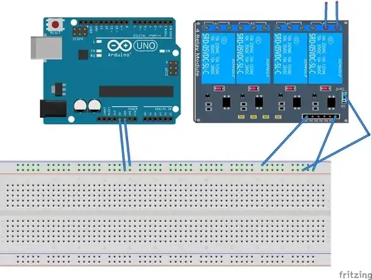

I'm working on a project that use J5, so is using the standard firmata, this project is using an opto 4 channel relay, when the board is booting the pins state are set to low, so as soon as I power the board my relay goes to a close state and make my motor run... this is a wrong behaviour for my purpose. How can I avoid that? By googleing around I stumble acros this:
A possible solution
but I can't uderstand if this is what I'm looking for.. plus I need only the PIN 7 to be set high on boot, any help please?
EDIT: SCHEMATICS
4 Channel 5V Relay Module
