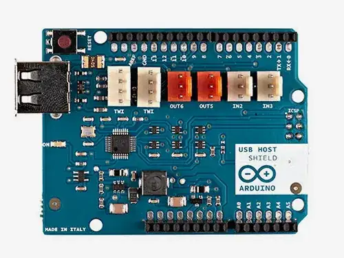

As suggested by Majenko, you can use the Arduino USB Host Shield: Picture of USB Host Shield

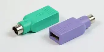

If you do not have access to a PS2 keyboard or just want to use a USB keyboard, Gerben further suggests that most USB keyboards can be converted to PS2 keyboards with an adapter: USB to PS2 adapter
The keyboard must be able to support both formats (USB & PS2).

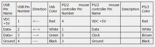

The following webpage shows the connections needed to go from USB to PS2: USB to PS/2 adapter pinout
Pinout connection

I am able to use this library: https://github.com/techpaul/PS2KeyAdvanced and USB's data +/- connected to pins 2+3 of an arduino to read keys on standard keyboards.
keyboard.begin( 3, 2); // D3= data+, D2= data-
A standard keyboard is one which doesn't need a driver to work on any computer. I'd tried several libraries, serial keyboard adapters, and ps2/usb converters, and this method works best. Since the ps2-USB converter is just a physical pin change with no logic, standard USB keyboards just magically with with the PS2 libraries; even caps lock and what not...
