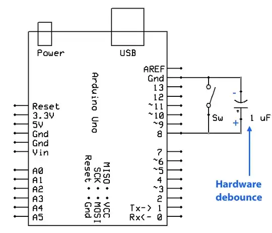

Yes, well when you release the button it may also bounce. In other words OFF/ON/OFF so that will count as a press. A capacitor over the switch might be better.
Example:
Hardware debounce
