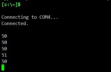

I've been rehashing some existing libraries I found on some obscure forums to measure a frequency on digital pin 5, using the ATmega328P/ATmega2560 Timer/Counter modules and an interrupt based approach in order to be able to measure frequencies up to 4MHz(-ish). However, using the code described below, the results are off by a factor of exactly 100. I used a frequency generator to accomplish these readouts. Here is an example of what I've been getting back when generating a 5000Hz square wave (50% duty cycle):
Can someone please point out what might be wrong. I've read the ATmega328P datasheet multiple times by now and it should just work! This is very strange.

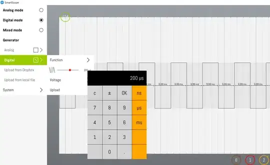

Edit: As it turns out the AWG I use has a blantant software bug which causes it to generate a wave with a period that's 100 times too long (see picture below). Nevertheless as Edgar pointed out I made some pretty big mistakes by not taking into account race conditions. Therefore the code below has been updated. Also, the test program has been updated to generate a 50% duty cycle square wave @5000Hz for testing purposes as suggested by Edgar.
AWG software bug
