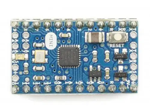

Arduino Mini
Arduino Mini

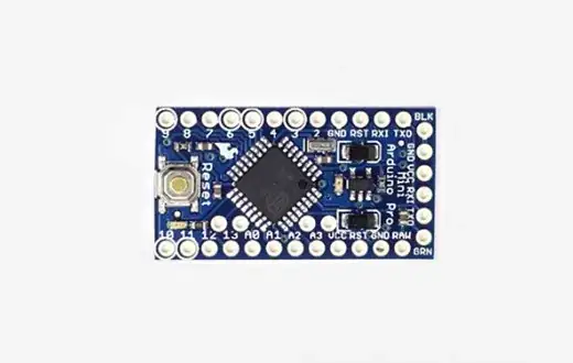

Arduino Pro Mini
Arduino Pro Mini

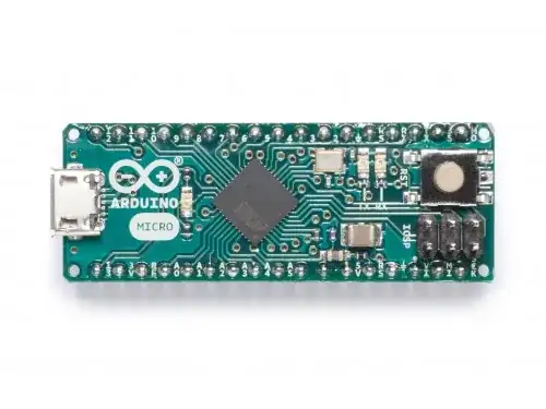

Arduino Micro
Arduino Micro

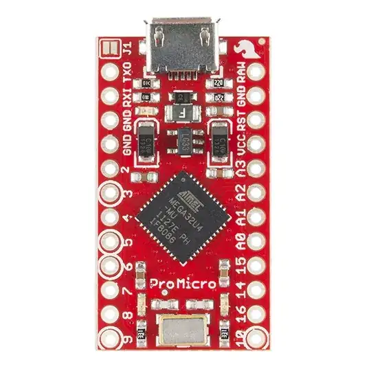

(Sparkfun) Pro Micro
Pro Micro

Arduino Mini: ATmega328
Arduino Pro Mini: ATmega328 (ATmega168 on older boards)
Arduino Micro: ATmega32U4
Pro Micro: ATmega32U4

Both Minis have 2KB of SRAM where as both Micro boards have 2.5KB

The Arduino Micro has 14 also (of which 7 provide PWM output)

The Pro Micro has 12 (5 PWM pins)

Arduino Mini/Pro Mini: 8 (some boards only break out 6 analog inputs)
Arduino Micro: 12 (6 dedicated and 6 from digital I/O pins)
Pro Micro: 9 channels of 10-bit ADC

Arduino Micro / Pro Micro: Native USB

Arduino Mini: 7-9 V
Arduino Pro Mini: There are two version of the Pro Mini. One runs at 3.3V and 8 MHz, the other at 5V and 16 MHz. VRAW can accept voltage up to 12VDC.
Arduino Micro: USB or external supply of 6 to 20 volts (recommended range is 7 to 12 volts)
Pro Micro: can accept voltage up to 12VDC

Arduino Pro Mini: The Atmega328 has 2 hardware interrupts available Arduino Micro / Pro Micro: The ATMega32u4 has 5 hardware interrupts available
