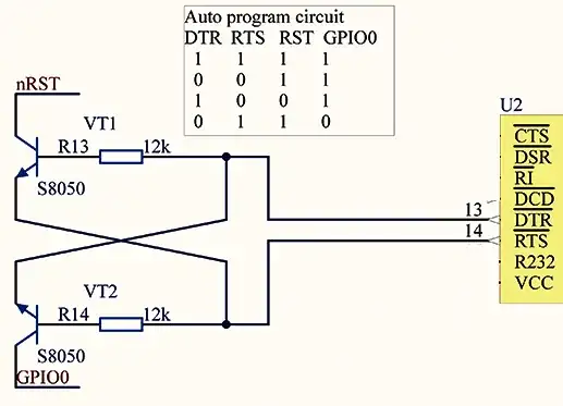

I actually had a doubt about what is the difference between the RTS signal and DTR signal ? I already know this that the DTR signal is used to auto reset when we use Arduino and similar MCUs. Can anyone say what is the major difference between these signals and what is their active state ?

12
DTS and RTS are used on esp8266 boards with USB (Wemos, NodeMcu) to reset the board and to set io 0 low for bootloader mode. You can see it in source code of esptool.py. Sometimes you want a reset without going to bootloader mode.
RTS = either CH_PD/EN or nRESET (both active low = chip in reset
DTR = GPIO0 (active low = boot to flasher)
