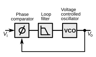

One simple approach is to simulate an analog PLL with a first order low-pass filter. Here is the first illustration of the Wikipedia article on phase-locked loop:
Schematic of a PLL
Some translation is needed between this analog picture and the digital domain: The phase comparator takes the difference between the measured offset x(n) and our previous prediction xe(n). The low pass filter is implemented as an exponentially weighted moving average. The output of the filter is our estimate of the drift rate: ye. The VCO is the formula for estimating te, which has the built-in drift rate −ye. This could be translated to C++ roughly along these lines:

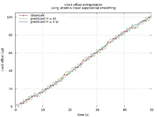

Here again, the optimal time constant should be of the order of the Allan intercept. Note that the limit τ → 0 gives the simple extrapolation of the previous section.
The figure below shows the performance of this algorithm on simulated data. The simulated clock has a drift rate oscillating between 1.7 and 2.3 ppm, and its measured offset is rounded to the closest multiple of 4 µs. The line labeled “predicted (τ = 0)” is the simple extrapolation of the previous section:
Clock offset extrapolation
Here, the large jitter of the simple extrapolation method is quite obvious. On this simulated data, Brown's method works well with a time constant on the order of 5 s. The frequency of a real clock would change much more slowly, and a longer time constant would work better.
