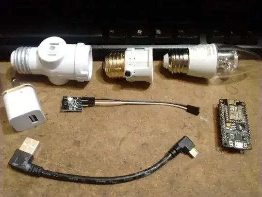

you can glue an LED controlled by an MCU into the sensor hole of a dusk to dawn sensor. these are available in socket and outlet shapes, are UL certified, and require no messy wiring. I've been able to switch an outlet model by duct-taping an ESP8266's built-in LED against the window; can it get any simpler?
Here's a working example's parts, exploded for easy identification. enter image description here
You can spot an inline socket-to-outlet adapter, a dusk-to-dawn sensor, a bulb, a cheap nodeMCU ESP8266 devboard, a short micro usb cable, a USB wall wort, and an RGB LED module attached to dupont wires. I'm wiling to bet anyone here can figure out how these pieces fit together to make a $10 "smart bulb". You can get most of these parts at the local home center, and everything shown on amazon/ebay.
Of course you won't get a lot of respect from EEs, but you will get the job done quickly and safely, and the opto-isolated controls work with any platform. I have cheaper/smaller build i've moved onto, but i still have several of these switch builds in-place for years and they work great.
I would recommend getting a dusk-to-dawn switch that is labeled as being compatible with LED bulbs; they tend to use a lower-"bleed" IGBT instead of the older/cheaper diac/triac combo which causes some low-energy bulbs to flicker when off.

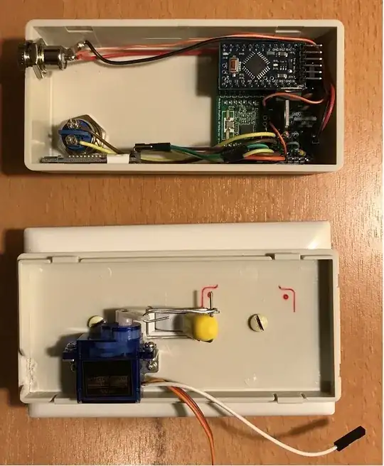

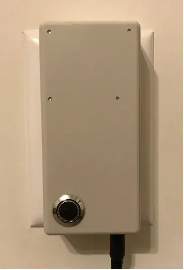

I have built a 'switch-flip' controller that just attach to the regular light switch. The controller has both RFM69 radio and Bluetooth module in it so it can use iPhone (iOS app only for now) to control the switch on/off.

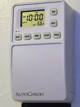

Walmart and others sell battery-operated units that can flip switches to turn lights off or on. Example: AutoChron Wireless Light Switch Timer, as seen in following picture.
You could buy one of these (for about $25) then hack into it and attach wires to the On and Off buttons to allow an Arduino to simulate presses of those buttons. The unit would move the switch handle accordingly.
