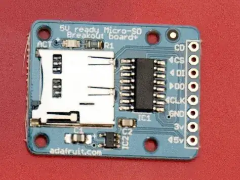

What? Yes, you can store data onto an SD card using a simple level-shifting piece of hardware like this:
SD card interface
