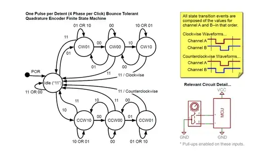

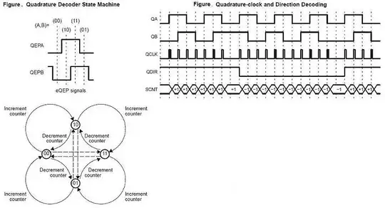

Edit 1, part 1: Ad hoc methods (such as just checking the state of input B whenever input A has a rising edge), while often simple to implement, can cause extra counts or missing counts. Extra counts may occur if A bounces and has several rising edges in a short interval. Missing counts may occur if rising edges of A occur faster than they are handled, particularly if the ad hoc code includes delays to deal with contact bounce.
Typical finite state machine methods for handling quadrature inputs, by contrast, automatically debounce A and B inputs, either by ignoring cases where a set of inputs repeats, or by counting an equal number down and up transitions as bouncing occurs. See for example the diagrams in reply #17 in “easy rotary encoder implementation” at eevblog.com – from which the first diagram below is taken – and in Omapl137 linux eqep driver at ti.com, where the second diagram is from. Both those sources provide substantial detail about processing quadrature inputs.
eevblog state machine with debounce ti state machine
