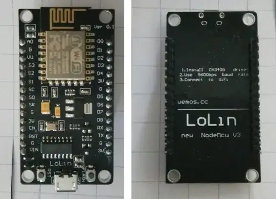

As for the ESP8266, strictly speaking I'm NOT using a straight ESP8266-12E, but a Development Board. Actually, I'm using a Lolin NodeMCU v3, this, that you can see here below:
Lolin NodeMCU v3

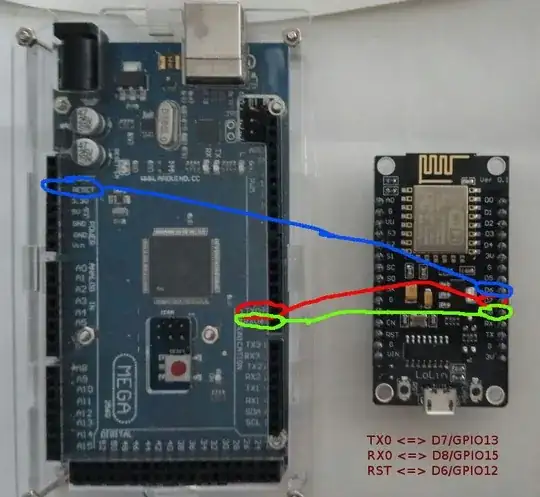

So, in the end, I connected the two devices following the official doc, with USART PINs swapped:
  • GPIO13: connect to TX of microcontroller
  • GPIO15: connect to RX of microcontroller and use a pull-down to ensure proper booting
  • GPIO12: connect to RESET of microcontroller
  • GPIO14: connect to ISP of LPC/ARM microcontroller (not used with Arduino/AVR)
  • GPIO0: either a 1k-10k pull-up resistor to 3.3v or a green "conn" LED via a 1k-2.2k resistor to 3.3V (indicates wifi status)
  • GPIO2: either a 1k-10k pull-up resistor to 3.3v or a yellow "ser" LED via a 1k-2.2k resistor to 3.3V (indicates serial activity)
As I don't need (currently) any LED feedback, I haven't used GPIO0 and GPIO2. Also, as I don't have an ARM, I haven't used GPIO14.
With help of this mapping I ended with following connection:

With all the above in place, up to know, I've been experimenting the following:
  • If I connect ONLY the RESET line and the TX/MEGA to the D7/GPIO13/ESP, I can succesfully reset the Arduino from the ESP-Link web interface and I can see the "console" of the MEGA (I can be sure of succesfully reset, as the counter in the Arduino console, restart);
  • Above apply:
    • when the MEGA is powered via a full-USB connection from a PC;
    • when the MEGA is connected via a power-only USB cable from the PC;
    • when the MEGA is powered via a USB-power-bank, but in this case ONLY if thereis a shared-GND between ESP and MEGA
  • As soon as I connect the D8/GPIO15/ESP to the RX/MEGA, everything still work, but up to next reset. If I "reset" the Arduino via the ESP-Link web-interface, it reset but.... never boot (I'm sure, as the "blinking" never start).
So, the last question:
Question 4: What's wrong with above testbed? Why the D8/GPIO15/ESP disrupt the boot process on the MEGA? I've swapped the UART PINs exactly to avoid this... as far as I understood...
