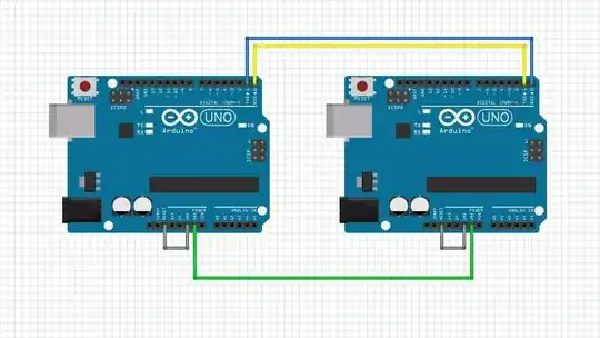

I'm trying out computer to computer serial communication using 2 Arduino Unos (both connected to different computers). Right now, I use the Software Serial library, which redirects data from the SoftwareSerial ports to the hardware Serial (over USB to the PC).
Is there any way to bypass the 328p chip, and only use the 16U2, which works as a USB to Serial converter? Will the circuit in the diagram work? By connecting the GND to RST on both the Unos, the 328p gets disabled, which in theory should all me to directly tap into the serial line of the 16U2.
Circuit

As per your diagram, ground the reset pin on both Arduinos and connect TX to RX on the one to RX to TX on the other. Alternatively, if your Unos have a socketed 328P, you can remove it.

The circuit you have drawn will work for PC to PC coms. Essentially your connection diagram looks like this:
PC1 -(USB)- Arduino1 -(TTL serial)- Arduino2 -(USB)- PC2
To answer your second question, you can bypass the 328p chip by removing them both as they are not needed. The 16U2 converts the USB to TTL serial which it provides to the Arduino on pins 0 and 1. Since the ATmega328p microcontrollers aren't being used (ie in reset state) then you may as well remove them and use them on another project.
