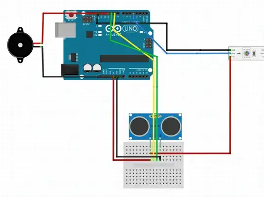

For this project I seek to create a counter of water glasses we drank throughout the day. I use for this an Arduino UNO card, a Piezo buzzer and a Neopixel rgb LEDs strip (5 LEDs for this test).
Aside from the last 2 LEDs that only light up to indicate to the user that his presence is considered by the product, I would like that when the HC-SR04 first detects our glass of water between 0 and 5cm (cheers!), the first LED lights up and stays on. When the first LED is on and the HC-SR04 detects a second time our water glass is between 0 and 5cm, then the second LED lights up and stays on as well. And so on. For each glass detected between 0 and 5cm, a slight sound sounds through the piezo buzzer.
By using the Adafruit Neopixel library (download here), I manage to make everything work as I see fit. However, I still have trouble programming if the LED n is on then the n+1 LED lights up at the next detection between 0 and 5cm, without all the LEDs lighting at the same time in a single detection.
I recently tried to use a boolean to identify when the LED n is true (ON/HIGH), but unsuccessfully. I leave you my code as is by thanking you for any help you can bring me.
See my layout and my code below: Arduino UNO + Components layout
