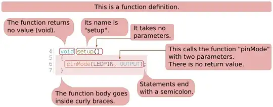

I have a page that explains the basics.
On that page is a diagram that breaks down what a function declaration looks like:
Function definitions
Nick Gammon
  • 38,901
