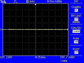

Here's a screenshot of digitalWrite (LOW):
digitalWrite (LOW)
That is, the output pin is at 0V.
Now for digitalWrite (HIGH):
The output voltage is 5V.

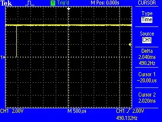

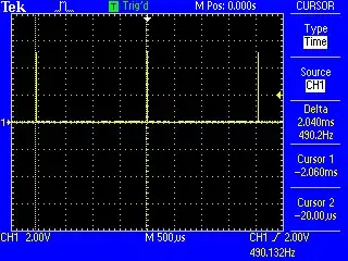

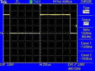

analogWrite really should have been named PWMwrite since it configures the processor timers to output PWM (pulse-width modulation).
Let's try analogWrite(1):
analogWrite (1)
You can see that the voltage level is 0V most of the time, and going to 5V for short periods. You also see that the frequency is 490 Hz which is what the reference page for analogWrite says it will be.

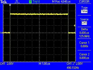

Zooming in:
analogWrite (1) - zoomed
The output is high for 8 µs, which is exactly 1/256 of 2048 µs which is the period of the timer. So, we have a duty cycle of 1/256 (0.39%).
Let's try analogWrite(127) - half-way from 0 to 255:
analogWrite (127)
Now you can see that the output is HIGH exactly half the time, and LOW the rest of the time.

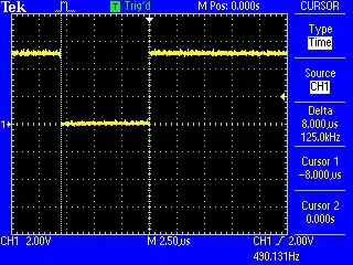

Let's try analogWrite(254):
analogWrite (254)
This is the opposite of analogWrite (1). The output is HIGH all the time except for a brief period. Zooming in:
analogWrite (254) - zoomed
Now the output is off for 8 µs - compared to the earlier image where it was on for 8 µs.
analogWrite (0) is the same as digitalWrite (LOW).
analogWrite (255) is the same as digitalWrite (HIGH).
