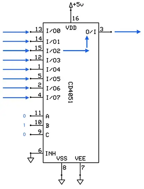

There are fairly inexpensive chips called "analog multiplexers" which let you choose one input out of a range (8 or 16 is typical). You could take the reading, then switch to a different input, and take another reading.
I have a page about analog multiplexers.
Example of it in operation:
Multiplexer
In this example you have 8 inputs, and by setting the A/B/C pins appropriately, one of the 8 is selected and appears at the O/I pin (output/input).
There is a 16-channel model as well. I see the 16-pin chip (74HC4067) available on eBay for $US 1.26 right now. You can get four of them (which would give you 80 inputs) for $4.88.
