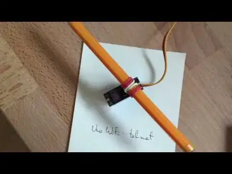

I want to control servos over WiFi with high precision and low latency. I managed to achieve this using TCP socket communication with Arduino Yún. I want to repeat this with Arduino Uno WiFi, but I can't find example code for socket communication. I connected to the board using telnet but servo output is jerky — as if there was a delay after each servo.write call.

Encouraged by this experiment I bought my own Arduino. I chose Arduino Uno WiFi (developer edition) because, unlike Yún, it's compatible with shields. Unfortunately I can't find example code for socket communication. I found an example that uses telnet, so I adapted it and used it with my Python script. Sadly, the servo movement is jerky — as if there was a delay after each servo.write call.
Below is a video showing both boards running two sketches: "no network movement" and "network movement".
Video

Arduino Uno WiFi reading from telnet
This is jerky.
