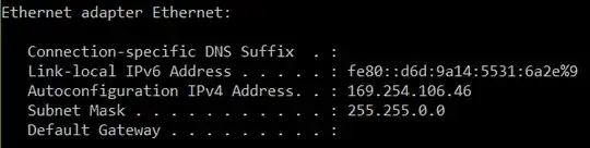

I found that my test computer connected perfectly to the camera without fiddling with any network settings as the manufacturer's documentation seemed to indicate. Here are the basic network settings my computer had when connected directly to the camera over ethernet (no Arduino yet):
IPConfig Settings
Notice the IP Address and subnet mask: 169.254.106.46 and 255.255.0.0 respectively.

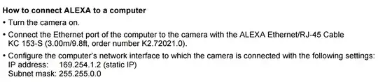

Just to note, these are the manufacturer recommended settings I found in some literature:

IPAddress ip(169, 254, 1, 2); //Manufacturer recommended address

IPAddress subnet(255, 255, 0, 0);

I understand that 169.254.1.2 is the manufacturer recommended address, but why did you use 169.254.106.49 for the test PC? It's very unlikely to be anything, but...
