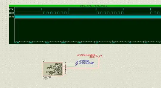

try this:
if (key_pressed()) digitalWrite(LED_PIN, (digitalRead(LED_PIN)==ON)?OFF:ON);
else digitalWrite(LED_PIN, OFF);
define ON/OFF based on your led connection.
Edit.
If you want the button too change the mode of led blinking, try this.
    if (btn_pressed())                  //if btn falling edge detected
        btn_status ^= 1;                //flip the last bit. btn_status += 1; works as well
    if (btn_status & 0x01) led1_flp();  //flip led1
    else led1_off();                    //otherwise, turn off led1
    //flip led2
    IO_FLP(LED_PORT, LED2);
the logic is fairly simple: if the button is pressed (active low), toggle btn_status. if btn_status is 1, blink the led1.
basically, press the button, led starts to blink; press the button the 2nd time, led stops to blink;
led2 is always blinking, to show concurrency of the code.
here it goes in action.
the code is written for a pic but basically runs on any mcu.
