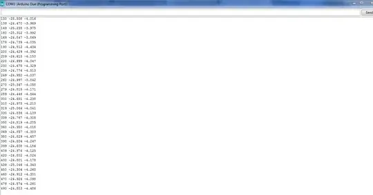

I'm writing a code to print/update the value of sensors for each 10 ms, and I decide to use Timer instead of delay function (I'm afraid it's not exactly 10ms with delay function).But when I watch the result on terminal, it stops running at about 0.5s. I guess there is a problem with my code in using Timer because when I remove timer, it prints normally. I debug all day but still cannot find any errors. I guess this is related to memory or pointer or print function.
Please help me :( !!
Here is the code. The code is very long but you can ignore all the unnecessary things:

Here is the result using Timer (stop at about 0.5 second): enter image description here
As noted in the last part of Nick Gammon's answer to the question How does the Arduino handle serial buffer overflow?, if the serial output buffer fills up, serial output blocks, waiting for an interrupt telling it it's ok to send the next byte out the serial port. When interrupts are turned off, that interrupt is never processed, so the program deadlocks. Don't do Serial prints in an ISR.
Looking at your code, it looks like a typical message has about 20 characters. Sending at 38400 bps, or 384 characters per second, it seems to me the buffer shouldn't fill, even if it's small (16 bytes) instead of large (64 bytes). However, I don't know of another explanation for the behavior you describe.
Summary: In your ISR, just store the current time and other relevant data in volatile variables, set a flag in a volatile variable, and in your main loop print stuff and clear the flag (or clear the flag and print stuff) whenever you see that the flag has been set.
Edit 1: I've struck out some erroneous numbers above. Here is a correction: 100 sends per second at 20 characters each is 2000 characters per second. 38400 bps of asynchronous data at 10 bits per transmitted byte is 3840 characters per second. So the raw data rate should be fast enough that the buffer ordinarily doesn't overfill.
