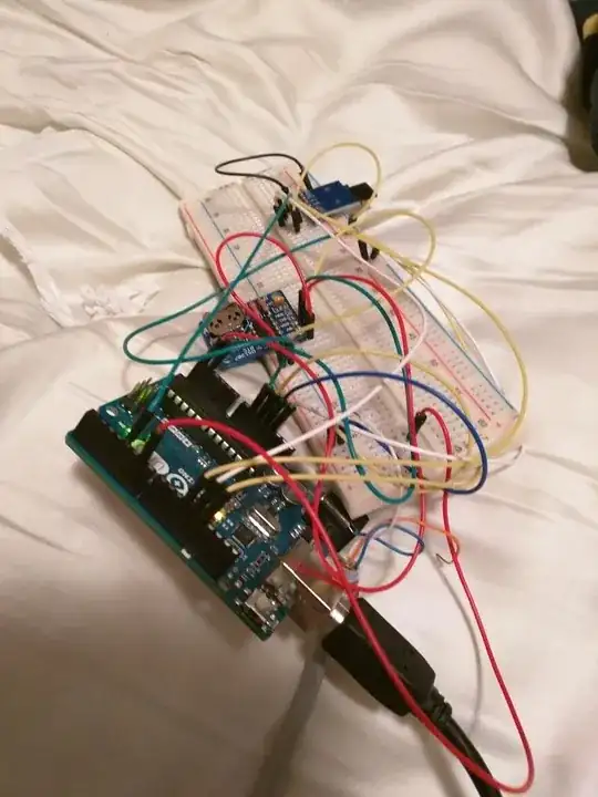

My board.
Arduino Board
I think I have it wired correctly (the lights aren't, but the board is).
I've read through the first few Google results to no avail.
My sample code to test the chip:

Had the same issue, however, my RTC was 1302 (not 1307) and yours seems to be as well, please check. If it's 1302, use this library: https://github.com/msparks/arduino-ds1302
Also, make sure you connect pins like this:
  1. Arduino Pin 7 goes to CLK
  2. Arduino Pin 6 goes to DAT
  3. Arduino Pin 5 goes to RST
  4. Arduino 5+ goes to VCC
  5. Arduino GND goes to GND
Kostyantyn
  • 141
Your picure shows also another device on the bread board. Remove that and ensure that:
Uno Ground --> 1307 Ground
Uno 5Volt --> 1307 +5v
Uno A4 --> 1307 Data
Uno A5 --> 1307 Clock
If the 1307 has a power led indicator, it should be lit.
If that still does not work, then in the code, comment this line out:
rtc.adjust(DateTime(F(__DATE__), F(__TIME__)));
and uncomment this line to set the 1307 with a specific time stamp:
// rtc.adjust(DateTime(2014, 1, 21, 3, 0, 0));
