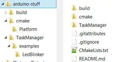

I have decided to put all my projects under a common arduino-stuff directory (which I commit to github as a whole, I know I could use git submodules for a better organisation on github, but had no time to check that yet).
arduino-stuff has the following content:
  • build: that's a directory where cmake and make will generate all their stuff (makefiles, cache, object files...); this one does ot get committed to github
  • cmake: that one is just a copy (unmodified) of Arduino-CMake cmake directory. This one gets on github so that it's easier for someone who wants to build my projects
  • CMakeLists.txt: that's the "global" CMake configuration that declares all defaults for my environment (board, serial port) and the list of build target subdirectories
  • TaskManager: this is my first project based on Arduino-CMake, this one is a library with examples; this idrectory also contains a CMakeLists.txt that states the targets for the project
