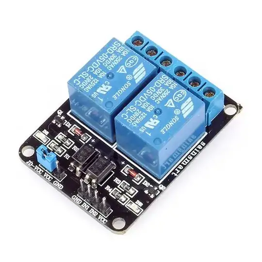

If you're using instead a relay module similar to the shown below, all the required interfacing electronics are already built into it and your digital pins won't suffer any overcurrent condition.
Commercial relay module

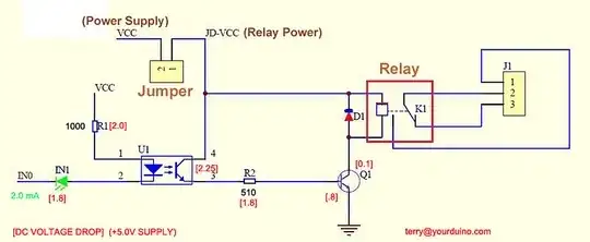

However, the regulator will (probably) still suffer from excessive current through it. In some of these relay modules you can optionally use a different power line (JD-VCC, see below) for the relay coil. If you own one of these, feed it directly from the 5V adapter, skipping the regulator.
Sample schematic for a real module channel
If the relay module doesn't have a separate power line, it may still work when connected to the 5V adapter if the dropout in the regulator is not too big (i.e., the "high" level from the digital pins is not too far away from the adapter voltage).
