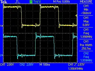

In case you are tempted to try this at home, I should point out that whilst the posted code above blinks two LEDs, it does so very rapidly indeed. In fact, they blink at 2 MHz - see screenshot. Channel 1 (yellow) is pin 12, channel 2 (cyan) is pin 13.
Rapid blinking of pins 12 and 13
As you can see, the output pins have a square wave with a frequency of 2 MHz. Pin 13 changes state 62.5 ns (one clock cycle) before pin 12, due to the order of the toggling of the pins in the code.
So unless you have much better eyes than mine, you won't actually see any blinking effect.

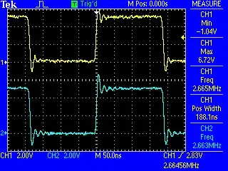

As an amusing extra, you can actually toggle two pins in the same amount of program space as toggling one pin.
int main ()
  DDRB = bit (4) | bit (5);  // set pins 12 and 13 to output
  while (true)
    PINB =  bit (4) | bit (5); // toggle pins 12 and 13
  } // end of main
That compiles into 178 bytes.
This gives you a higher frequency:
Very rapid blinking of pins 12 and 13
Now we are up to 2.66 MHz.
Nick Gammon
