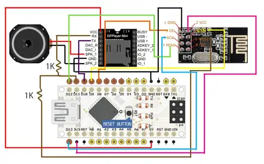

I'm working with an Arduino Nano board clone (CH340) on wireless control of DFPlayer Mini, transceiver sending a Struct variable with MachinePrefix (just in case), sound type (I have more folders by type of machines) and number of sounds.
The transceiver works fine, but the receiver doesn't. If I upload data into the Arduino, the DFPlayer plays the first song once (row 43 - myDFPlayer.play(1)), but after nRF24 init is not working.
After nRF24 init I'm still receiving data in valid format and range. If I comment out the nRF24 part, the DFPlayer is working, but together not. I read about working two devices on one SPI bus but I don't understand what's wrong. I think the problem is the same MOSI pin. In my opinion it should work but did not.
Any suggestions?

Image of circuit
dda
  • 1,595
novluk
  • 43
When using SPI, pin 10 should never be used as an INPUT. Otherwise the Atmega can go into SPI Slave mode. But you use pin 10 as the RX pin.
Just swap pin 9 and 10, and update your code accordingly.
