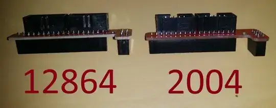

I solved the problem myself. It turns out to be a problem of wrong pinouts.
My PCB of the project was originally designed for the LCD2004 counterpart, and I thought it was a drop-in replacement for 12864. But no, it's not.
RAMPS Smart Adaptor 12864 vs 2004 This is the "Smart Adaptors". Notice that the orientation are 180 degree different.
If you have the same problem not lighting up a 12864 when switching from 2004, or vice versa. Check your orientation as above.
My solution will be crimping a different JTAG wire instead.
